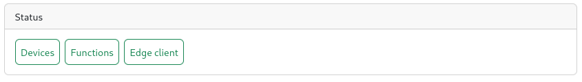

and everything should be up and running. You can verify that it works by looking in the IoT Open web gui on the installation and there should be a green "Edge Client" symbol.
[upl-image-preview url=https://forum.iotopen.se/assets/files/2026-01-02/1767353520-665522-image.png]
